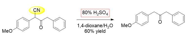

各位朋友,请问
硫酸
条件下脱氰基是什么反应?
文献上收率还可以,可我做的时候,都碳化了。
文献方法:
A solution of substrate(3.09 g, 9.82 mmol) in 1,4-dioxane (5.5 mL) and 80% H2SO4 (16.4
mL) was heated at 105 °C. After being stirred for 17 h at 105 °C, the reaction was
stopped by adding H2O.

是氰基酸性水解成羧酸,然后β脱羧的历程吗?
