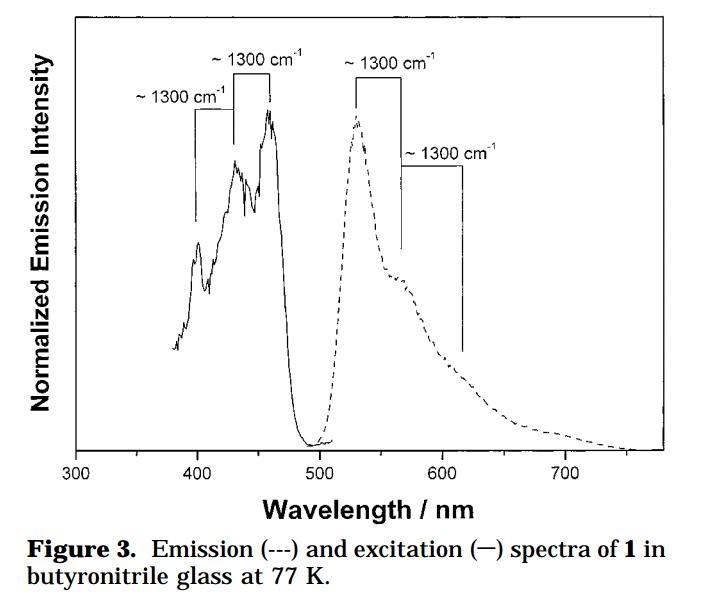

荧光光谱振动结构区分?
如图,激发光谱曲线和发射光谱曲线均标注了1300 cm-1,如下是文献中对该图出现的1300 cm-1,最直接的描述。
The butyronitrile glass of complexes 1-5 upon excitation at λ > 350 nm
show well-resolved vibronic structured emissions at 510-580 nm with
progressional spacings of ca. 1300 cm-1, which correspond to the aromatic
vibrational mode of the terpyridine ligands.
我想问:这个数值是如何计算的?
360截图20190405092003274.jpg 显示全部

,销售 2019-04-14回答
能量换成波长就可以了
